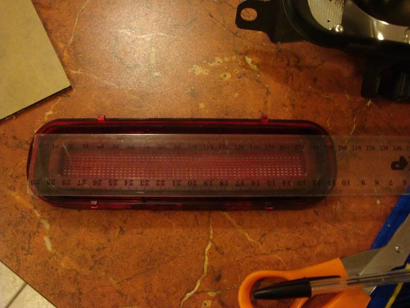

Making the template (this is the most IMPORTANT part of the whole process)
Measure the length and height of the inside. Draw a basic outline cardboard and cut out and make sure you have the right shape and it fits in neatly. Once you have the shape mark a line down the centre 15cm long. Now divide it so your leds will fit equally and fit them in. Place inside your lens and see how it looks, I had to adjust mine a few times hence the markings but you will know when it looks right.

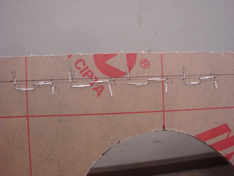

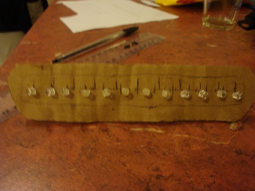

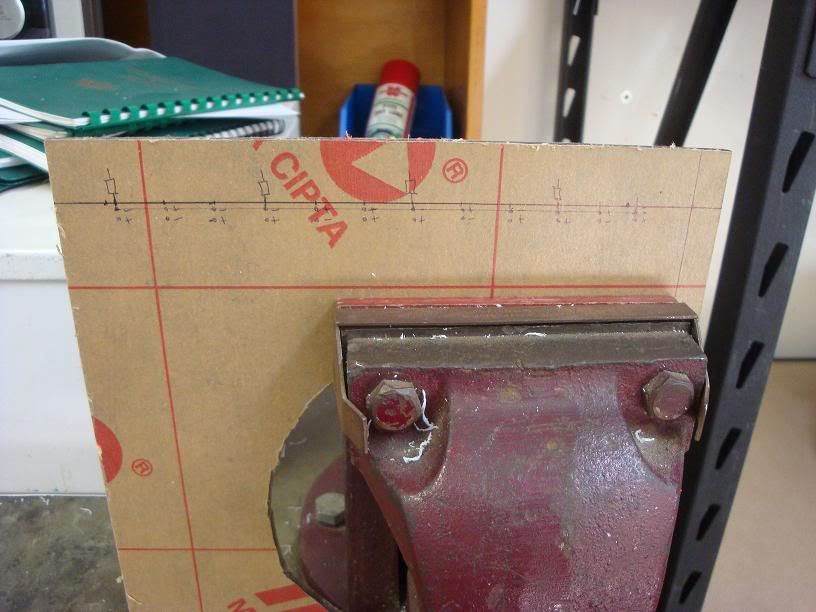

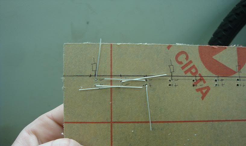

Next mark your Perspex outline and where your leds will sit. Remember you want the LEDs to be in a perfect line so take your time with the marking. Next cut the outline with the dremel and make sure it fits neatly in the lens. Adjust as required. Once happy drill your holes for the LED legs to go through.
On the back mark your + and – signs and where your resistors will sit. This will make life easier. Next place in your LEDs. I pushed the legs down to hold the LEDs into place and makes it easier for your soldering effort. Below is a few in progress shots. Please note I put my input resistor and diode on the board instead of within the wiring like I did in the tail lights.
Next get your soldering iron out and start soldering. Once completed mine looked like this:

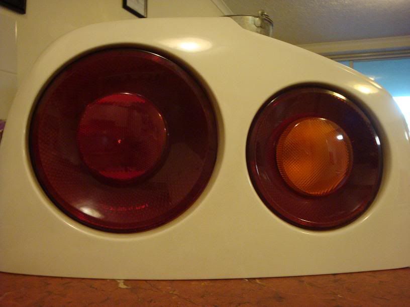

First thing is to remove your tail lights, the 10mm bolts unplugging the plug and simply sliding it all out and should look like this;

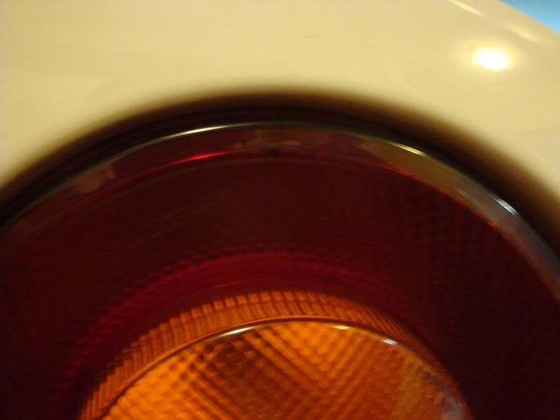

Remove the outer painted part by removing all the phillips head screws and take out the wiring harness...also on both sides mark top dead centre, this is important;
Next turn your oven onto 100 degrees and place the surround in for about 7 mins to heat up the goo. Pull it out and gently pry out the lenses, you may need to place it back in the over for a minute or two to reheat or get a tad more heat in. Be gentle with them.

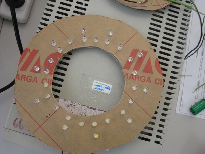

This part is for the outer lens LED pattern: Divide the circle into twenty even parts. I started with placing LEDs 5mm from the inner circle. Place your outer LEDs 1 cm from the inner LEDs and starting at the top place one LED for every two inner LEDs, please see the photos for the pattern. Place the cardboard cutout with the LEDs insie the out lens making sure you align the top dead centre of both the cutout and LEns. Although the lens look like perfect circles they are on an angle, at this stage its a case of test and adjust the LEDs so they look good from the outside. Take your time with this part as its how it will look. You will see on my cardboard cutout i circled the final positions of the LEDs due to there being a few holes in the end. Also note on my cutout how the LEDs are not in a perfect circle.
For the inner lens repeat as above but this cirle is broken into 16 pieces and as above you need to place inside the lens and look at it from the outside. Make sure you get it right.

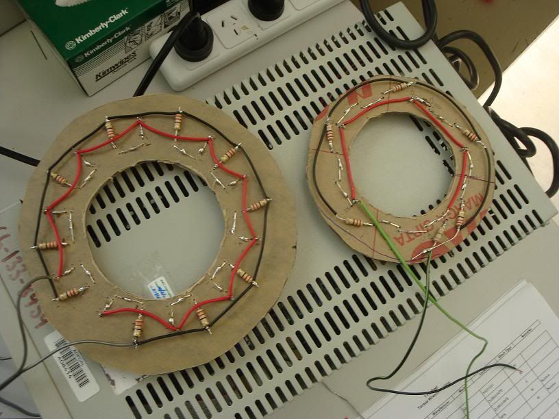

On the back mark your + and – signs and where your resistors will sit. This will make life easier. Next place in your LEDs. I pushed the legs down to hold the LEDs into place and makes it easier for your soldering effort. The pattern for the markings is as below:
once the leds are in the board it will looks like this:
Test the circuit:
