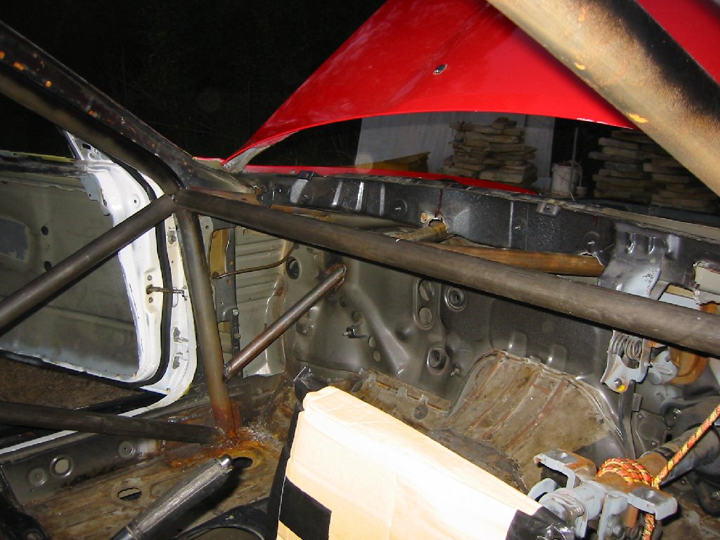

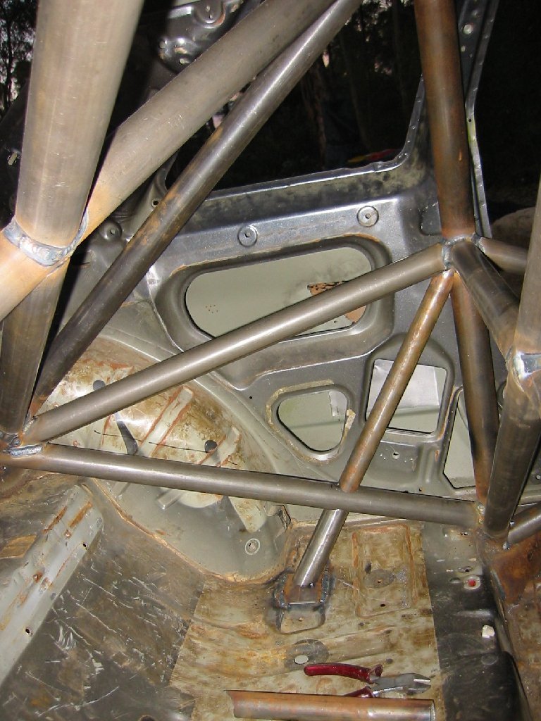

we don't really have a good pic but the rear parcel shelf has been cut out too. you can see it in the roll cage pics.
speaking of which....Mark has been working on the cage for weeks. thankfully with rob who knows what he is doing lol
it looked roomy back there for a while without the parcel shelf.
plenty of bracing, cross bracing and even support for the subframe mounts. don't think we'll need a rear strut brace now

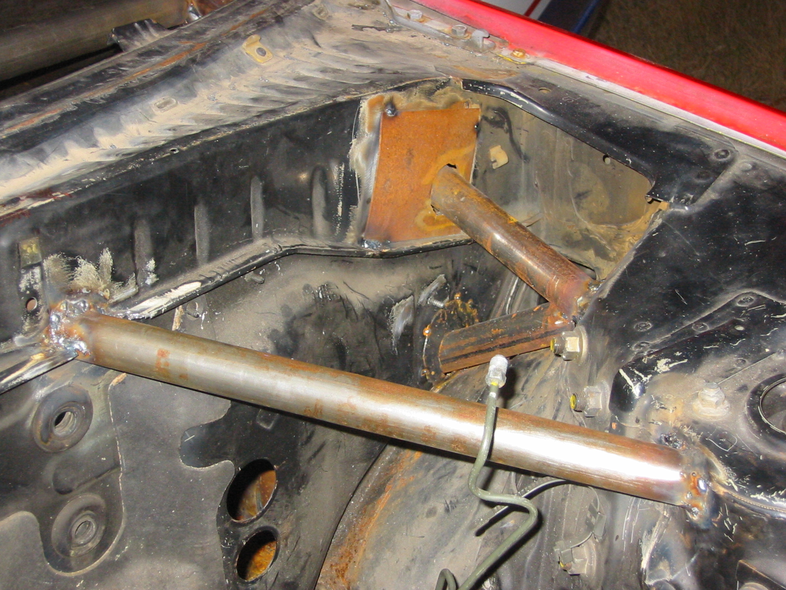

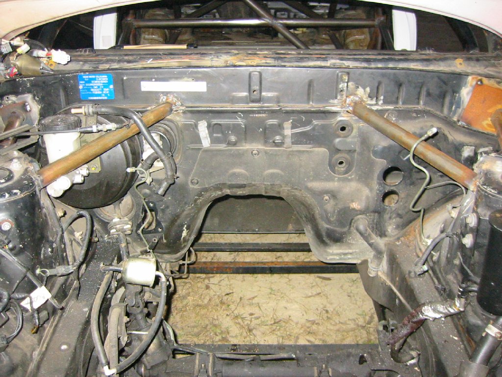

front of the cage was a bit trickier. we wanted to support the front strut tower properly so we had to loose the
brake booster
abs
wiper motor
clutch master resoviour
brake lines
i guess some of those things will go back in somewhere later (1, 4 and 5 hopefully)
its a bit close to the throttle inside but other than that looks great. and all the holes in the firewall have been welded up to. and the speedo cable hole so i guess we wont be having one of them lol

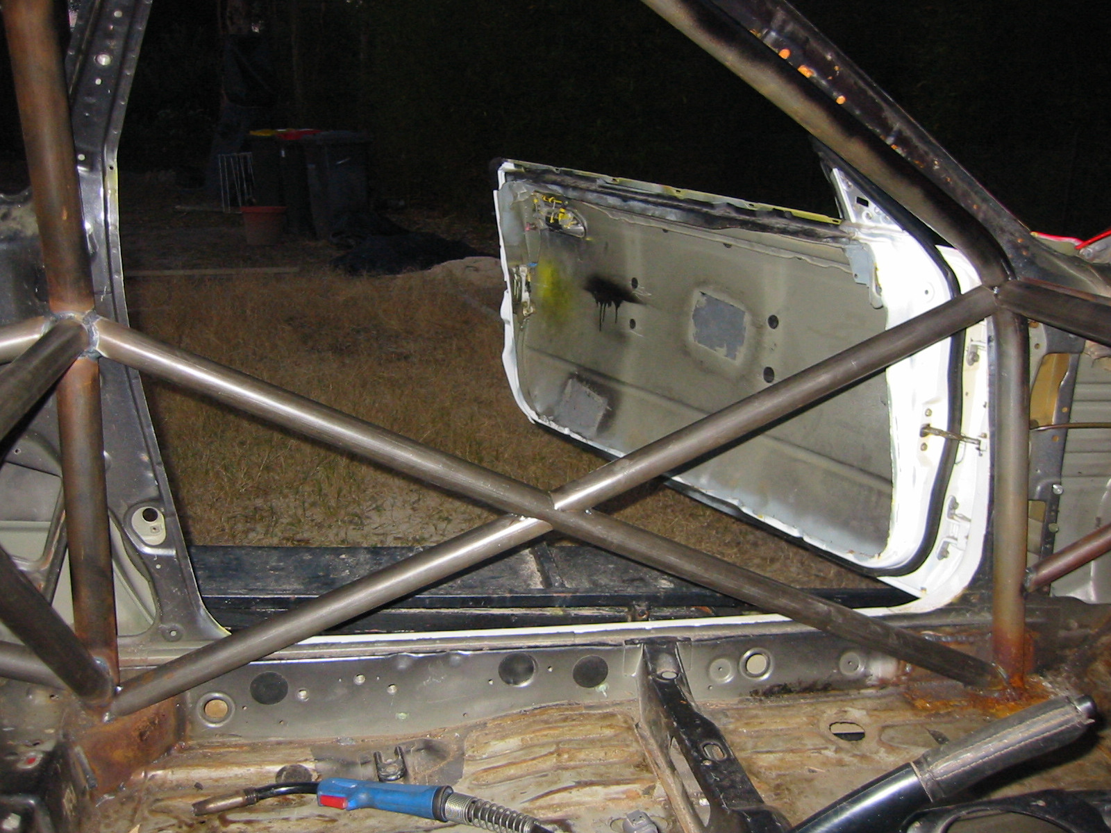

we've braced the cage to the a and b piller in 4 places too
heres the side of the cage. could be tricky to get out in a rush
which also kind of gives away the minor mods to the doors
they are getting ally skins once the windows are in - although i think we might have gone a little too far around the hinges - they flex so much the paint has cracked. might need to start again with them.
about 2k spent on that materials and labour probably. and a absolute heap of work
